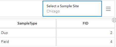

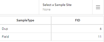

Ah. For that, you need two widgets:

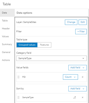

The Table Widget:
  • Use your raw layer as input
  • Set table type to "Grouped Values", group by sample type, define a count field

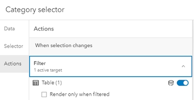

The Category Selector Widget:
  • can only be added to a Top/Sidebar Widget, so add that first
  • set to "Grouped Values", use the same layer you used for the Table widget
  • group by site
  • add an action to filter the Table widget
JohannesLindner_3-1683970584762.pngJohannesLindner_4-1683970597690.pngJohannesLindner_5-1683970612835.png
Have a great day!
Johannes
The Table Widget:
  • group by site
Have a great day!
Johannes
