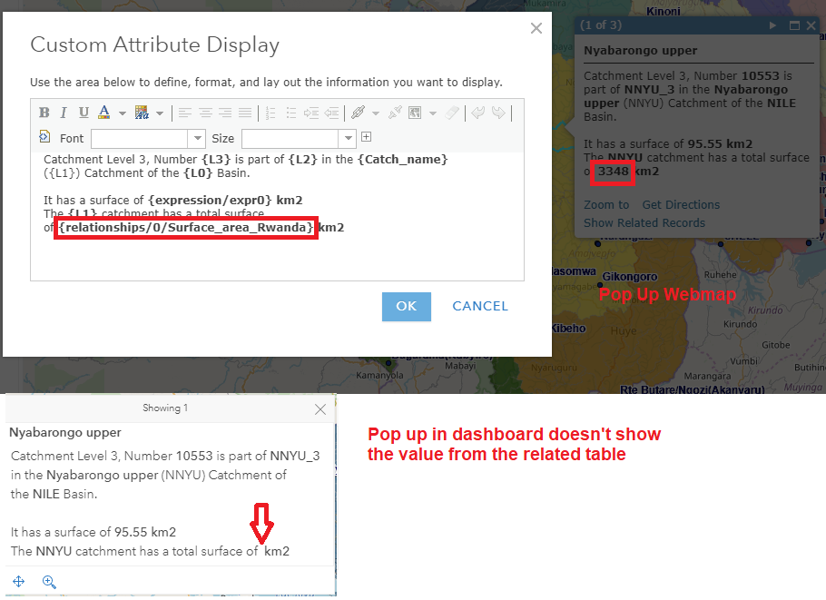

Hello,
I'm wondering if this is a bug or if it's just not supported.
In my web map I configured the pop up to show a field from a related table (The relationship is M to 1, i.e. many geometry features are related to 1 table row). For this case, the statistical operator doesn't matter (sum, ave, min, max) as there is only one related record.
The web map popup looks as expected, but in the web based ops dashboard the value is empty.
Thanks for your assistance.
Annina

Hi Annina,
Apologies for the late reply on this thread.
You've run into a current limitation of Operations Dashboard. Related tables are supported at the visualization level, but not currently in pop-ups from the web map.
FYI, if you want to interact with related table data in an element, please see this thread
https://community.esri.com/thread/170745?et=watches.email.outcome
(specifically, the 2nd last post in the thread by Tif - dated Mar 9th)

AnninaHirschi_Wyss1
Hi Derek Law
Thanks for your reply, I hope that this will be supported soon. It's a pity that the pop up doesn't honour the related table fields, that's why I might have to disable the pop up in my dashboard: See the second last chapter in this https://arcg.is/amLXn story map.
