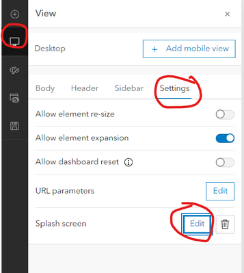

Hi all,
I'm trying to figure out if it's possible to display a message during the initial loading time of the dashboard (before maps/indicators show up) as my dashboards takes around 20s to load right now, and I don't want users to quit, thinking it doesn't work.
I couldn't find any documentation on this, so any help is appreciated !

SteveOwens
You can add a Splash screen that will show any message you want. See below.
SteveOwens
RemyOlive
Hi Steve,
Thanks for the reply, I didn't know that it would pop-up directly !
Have a good day,
Rémy
