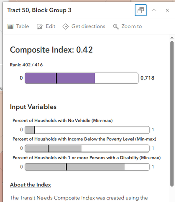

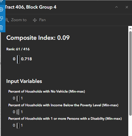

I have some pop-ups not displaying properly in a dashboard. They look great in map viewer, but in the dashboard the graphic bar is squished. Images below. I did not code this pop up, it comes from ESRI. We used the Calculate Composite Index Tool and with the output you get a nicely designed popup. I will say this level of arcade coding is over my head. I poked around a bit and tried to change some of the code that I thought affected the width of the bar chart, but no dice. I've attached the code below as well. Any suggestions?

KassieKM
I turned to chatgpt and found the culprit!
I changed these lines of code:
var figure = '<figure class="table"><table style="border-spacing:0px;margin-left:20px;margin-right:20px;margin-top:5px;margin-bottom:5px;'+fontSize+'"><tbody><tr><th></th>';
var endFigure = '</tr></tbody></table></figure>';
To...
var figure = '<table style="width:100%;border-spacing:0px;margin:5px 0px;'+fontSize+'"><tbody><tr>';
var endFigure = '</tr></tbody></table>';
And now all works well!

Maybe where it says Margin left & right reduce to 0 px rather than 20 px.
KassieKM
Nope, nothing. Thanks again for the suggestions!
KassieKM
To...
