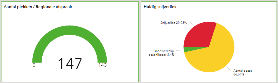

Hello,
my pie chart doesn't show anything while there is actually something to show.
The text says "no data" when I select this object, but it works for any other object (see below).
I'm very sure there actually is data, because in the chart next to it it shows 7.
Does anyone know why this is happening and how I'm able to fix it?
Thanks!
jcarlson
MVP Alum
How is the data being filtered in the first image? What fields are selected for the pie chart? What do those records actually have in the table for the fields in question?

Mark_VRBN
Ha, your answer wasn't the solution but it made me look through my data to find the problem! In the data the field was called "Sint Michielsgestel" while the selector was filtering on "Sint-Michielsgestel". That's why. Thanks!
