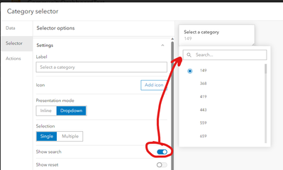

I think the easiest way to solve this is to abandon the search functionality in the map widget and instead add a category selector, with search enabled, to your dashboard. You can configure how many matching results the selector should show when performing a search.
Use selectors—ArcGIS Dashboards | Documentation
