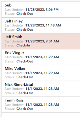

Here is the dashboard list on the desktop:
Here is the dashboard list on the phone.  The criteria for the background color was edited and saved.  The desktop version updated, but the mobile version on phone has not updated.

That's really strange, it's not even formatting the text the same. They're the same dashboards?
I know AGOL has mobile views for dashboards now, but I haven't gotten to test them out any, being on Portal. Is it possible that the mobile version is looking at a different widget entirely?

Did you manually update the mobile view list after you made changes to the Desktop list?
