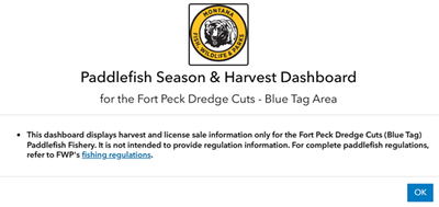

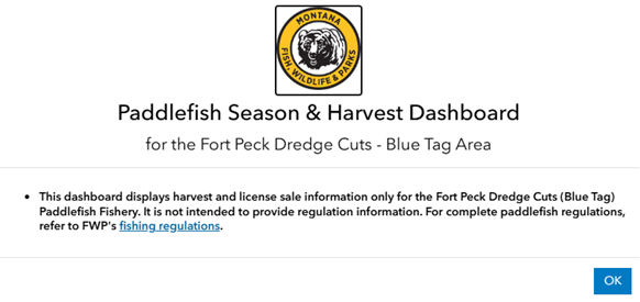

We included a logo on the splash screen of a new dashboard and added a URL link to our agency web page. There is a border around the logo that is visible upon loading the splash screen and disappears if the user clicks anywhere. The border seems to be associated with adding an Image URL to the logo in the splash screen configuration. If the logo does not include a URL, the border does not appear on the logo, but shifts down to the next weblink on the screen. In this case the link to the fishing regulations. We also have a button to reopen the splash screen once the user clicks OK. When reopened the border is not visible. Once the page is refreshed, the border reappears. This border highlights the "active cursor" since if you click enter without clicking the mouse the link to the page is activated. It seemed this might be related to Web Content Accessibility however, there is nothing on the Dashboard Splash Screen help indicating this.
Is this expected behavior?

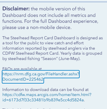

@AdamMesser1 We had the same thing happen, on the splash screen of the Mobile view. I certainly did not expect it and could not find a way to get rid of it, either. Same thing, the outline goes away when you click anywhere else, or doesn't show at all when there's not a link. On our Desktop view, I used a Sidebar instead of a splash screen, and that didn't have the weird outline.
