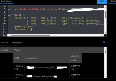

I have a map layer that I would like to link to a featureset by a description field. In the featureset from the description field I've created a column of four value types.

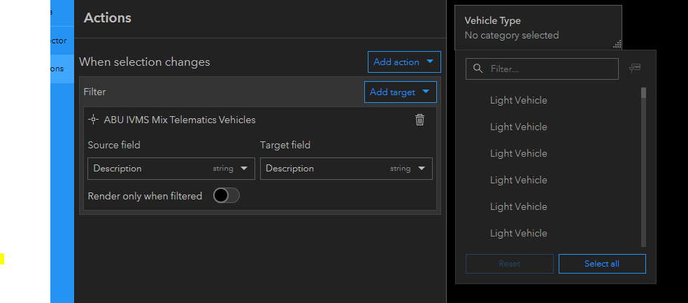

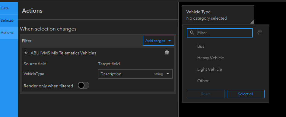

In a category selector I tried to use the Grouped Values on the four value types as the selection but I'm unable to link the two by the description field as you can in the Features.
In the Features option I've linked the description fields from both, however the selection category provides a list of 600 values of the four value types, is there anyway to get these grouped to just show the four values?

A grouped values selector ignores other fields. It would be extremely confusing otherwise, to select "Light vehicle" and have your other items filter on something other than the attribute "Light vehicle".
You might be able to do something with a Data Expression if you reshaped the data a bit. What are the values in the description field, though? Can you share what the data actually looks like?

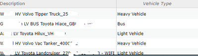

Thanks for the reply, there's about 500 records with a unique description for each. They can be broken into four vehicle categories; Light Vehicle, Heavy Vehicle, Bus & Other. I've created a field in the attribute table via an expression in the Web Map for Vehicle Type, unfortunately his does not carry into the Dashboard.
I have created a data expression in the category selector, and this is the featureset that I'm trying to join with the IVMS vehicles layer to hopefully group on, but without success
