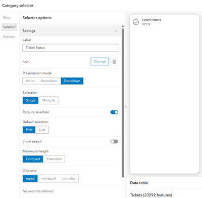

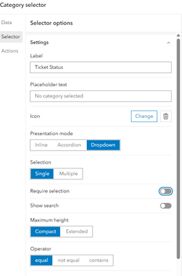

No Default selection option when "Require selection" is toggled off
Default selection when "Required selection" is toggled on:
