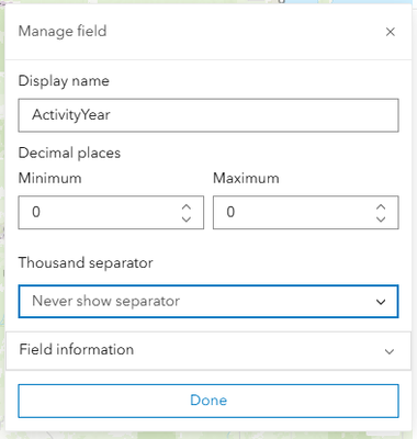

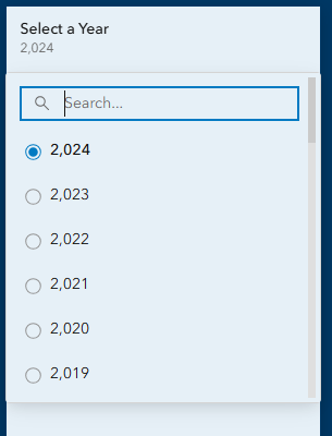

I believe previous to the June update category selector presented the format set for the later in AGOL. After the update commas are showing in my selector even though I have them set to never show comma in AGOL.
There appears to be no control for this in Dashboards, honestly can't remember if there was before, and know control of the way these formatted has been ongoing across all the apps. This appears to be a step backward.  Let me know if I am missing something. Usually the AGOL formatting did the trick.

I tried on one dashboard and I did this:
I went to General > Selector > Load categories > Done.
It solved for now, and I saved the dashboard.
I will figure out if this will be a solution of if it is going to lead to further issues in the future.

Thanks @PanGIS this worked.
Edit: Its weird cause other selectors, similarly formatted didn't need this.
