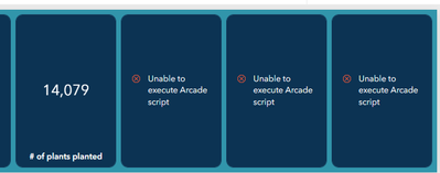

I think this explains why the update broke these indicators. I had set up this dashboard as an embedded stats bar and it was working before the update yesterday.  I had some custom code in there with spacers so the text would stay a uniform size, luckily all I need to do is add a brace on the end of the code to fix it as you can see in the left-hand indicator.  I guess the code got truncated when TextMaxSize  was removed? Some of these dashboards are public facing, so this is very disappointing. I'm hoping a patch will be released promptly to fix this an the other issues we have noticed with this rollout
