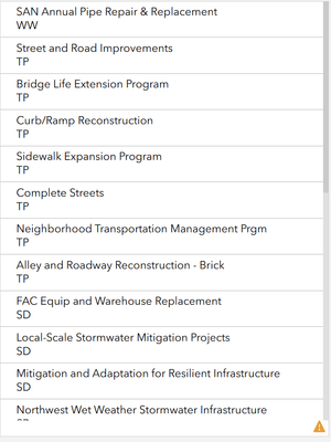

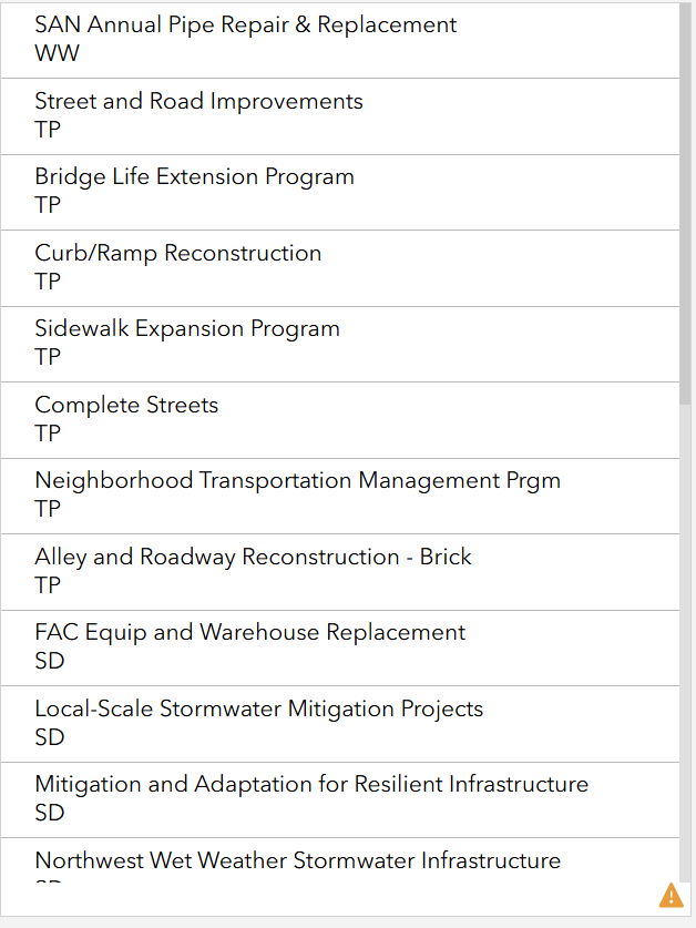

Hi all -
I am trying to build a dashboard list widget use a layer and a table join. I used the following expression and was able to get the data I wanted but I keep getting a "cannot access data" yellow triangle in the corner of the widget. All sharing is set to "everyone" with groups on. Has anyone else run into this issue before??
Portal and ID's have been removed.
