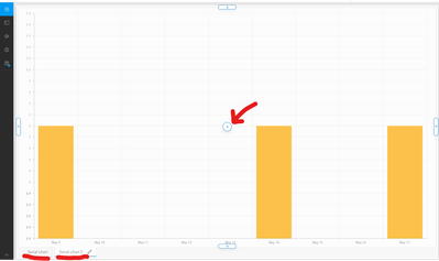

Is it possible to navigate between multiple chart views in ArcGIS Dashboards? It would be helpful for example, if you need to illustrate  2 serial charts, but do not have the screen real estate to display them at the same time.
As seen in the screen capture above, Experience Builder has a navigate view feature, where you can click a link, an arrow or a number to toggle between additional views. Does a similar feature exist in ArcGIS Dashboards for serial charts?

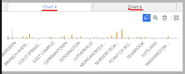

If I understand your query correctly, it is definitely possible to stack your serial charts on ArcGIS Dashboards.
To do this, once you have added one serial chart to your dashboard, you should be able to add another serial chart in the same space as the previous chart, stacking them up.
In the screenshot, you will see that I have stacked two charts and can stack another on top of these, using the element button.
Do let me know if you have any further questions.
