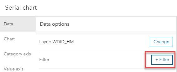

You can apply filters to any data-driven element. In the Data tab, just below your data source is a filter option. Any filters added here will only apply to the specific element.
Apply Filters
