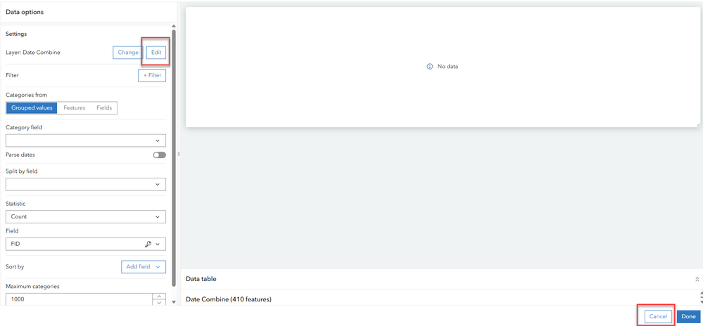

One thing that drove me crazy was was that every time I modified the data expression, the filter and category field under the Data section for the table would be cleared. This caused my table to have no data, then I'd realize that I had to reset the filter and category field. This happened whether I clicked on Change or Edit when modifying the layer to edit the data expression. I don't know if this is by design or if I should modify the data expression some other way.
JenniferAcunto
Yeah that is annoying. I've found that if you edit the data expression, but cancel out of the element you won't lose your configuration and will still have the updated data expression feeding into it.

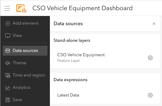

Thanks for the helpful tip. I discovered another way to edit data expressions. Using the Data sources section while editing the dashboard, I can edit the data expression. I have to click the gear icon then the pencil icon.
