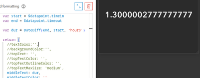

This is what it looks like. I'm trying to create an Indicator on a dashboard. The indicator says "Unable to execute Arcade script"
var startDate = Date($datapoint.timestart);
var endDate = Date($datapoint.timeend);
var age = DateDiff(endDate, startDate, 'hours');
return {
  //textColor:'',
  //backgroundColor:'',
  //topText: '',
  //topTextColor: '',
  //topTextOutlineColor: '',
  //topTextMaxSize: 'medium',
  middleText: age,
  middleTextColor: '',
  middleTextOutlineColor: '',
  middleTextMaxSize: 'large',
  //bottomText: '',
  //bottomTextColor: '',
  //bottomTextOutlineColor: '',
  //bottomTextMaxSize: 'medium',
  //iconName:'',
  //iconAlign:'left',
  //iconColor:'',
  //iconOutlineColor:'',
  //noValue:false,
  //attributes: {
    // attribute1: '',
    // attribute2: ''

Are your fields actually dates? If so, you don't need to use the Date function.
PS - You may want to use Round or Text to format the output nicely.

aprhyde11
Yes the time fields include the date and time. I'm using the start and end functions built in to survey123.
Unfortunately, it still isn't working for me  😭
Thank you so much for your help though!
jcarlson
MVP Alum
Can you just confirm that it's a true DateTime field, and not text? I've had surveys store other datatypes as text in the past.
- Josh Carlson
Kendall County GIS
aprhyde11
It is by date
