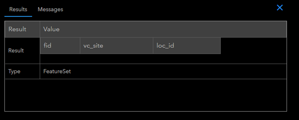

Testing returns this:

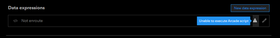

When I save and go back a screen, I see the error that it's unable to execute Arcade script:
I want to be able to display the {vc_site} and {loc_id} that is returned.
