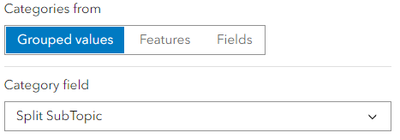

In the serial chart I'm using categories from grouped values on the category field Split SubTopic.
In the category selector I'm also using categories from grouped values with the category field of Split SubTopic.
The category selector works on widgets with other data sources but the serial chart with the same data expression as the source displays a "Cannot access data" error when it is filtered.
Does anyone have any ideas why this might be?
ArielLow2146
I was able to resolve this issue by removing the _ from the field name. I switched Split_SubTopic to SplitSubTopic.
