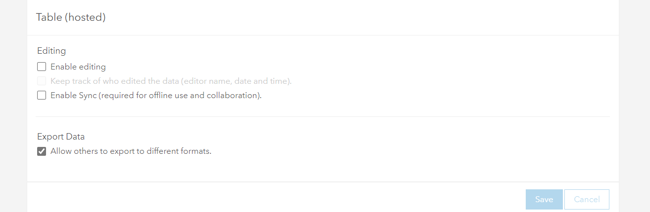

Hi, is there any possibility to export results in the CSV format? I am using the ArcGIS 11 version, I have select the options to export the table in my hosted service setting but still the download option is not enabled for the table from this service in the ArcGIS dashboard interface. Am I missing something ?

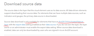

We are having the same issue in enterprise 11.1.  Add a hosted feature service layer as a table in dashboard, there is no option to download the data as CSV.  Unfortunately I believe this is expected behavior based on the help documentation https://doc.arcgis.com/en/dashboards/11.1/create-and-share/download-data.htm
This is a great feature in AGOL, would be great to have in enterprise.

I'm wondering if support for downloading data from hosted tables (rather than hosted feature layers with actual geometry) was dropped or screwed up in a recent update? I have a dashboard more than a year old that consumes a hosted feature table with no spatial info, and the download option was available and working all that time. Recently, I noticed the download button stopped working and would give a 505 error instead. Now (not sure if related or unrelated) my hosted table went corrupt or something and I had to re-upload it entirely, but no matter what I do I can't get that download toggle to appear again, despite having the Extract capability enabled in the item settings.
