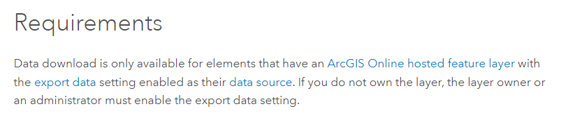

However, it is a little confusing/contradictory when looking at the online help though. Within the "download source data" section of this resource - https://doc.arcgis.com/en/dashboards/create-and-share/download-data.htm, there are the following statements made:
"Tip: You can limit fields that are downloaded by using a feature layer view."
However, in the very next paragraph we have this stated: "When downloaded, the data includes "all" fields in the layer or view, including any fields that are not visualized."
So the export function will export "all fields" regardless if you have a "feature layer view" being utilized within the module.
There are other means of achieving the export, but this would be a great feature if it worked. Could this be a bug that has not been reported?

Are there plans to make the "Download data" in ArcGIS Online - ArcGIS Dashboards compatible with Feature Services coming from ArcGIS Enterprise (Portal/Server)? (not just Hosted Feature Layers as current Download data—ArcGIS Dashboards | Documentation)
Thanks
Pat
AaronKoelker
Would really like this functionality as well. Quite unfortunate for organizations utilizing both Enterprise Portal and ArcGIS Online together.
