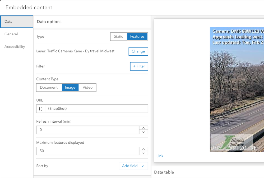

I'm not totally clear on what you want to do but you can set the source of the embedded content widget to the layer, pulling the URL of the image from a field in the layer.

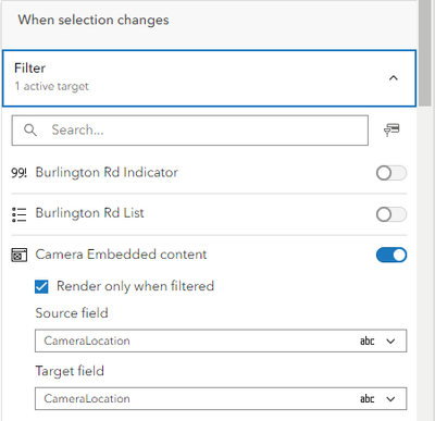

Then configure an action that filters the embedded content widget when the layer selection changes. The example below filters the widget from a list but I think applying the filter from the map would be similar.

Set the source of your embedded content widget to your Bike Pathways layer with the URL property set to the field that contains the link.

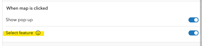

On the properties page for your Map widget, on the "Layer actions" tab, turn on the "Select feature" option under the "When map is clicked" heading.

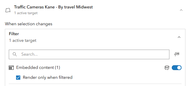

Then under the "Layer actions" for your Bike Pathways layer, configure a filter action on the embedded content widget when the selection changes.
That seems to work for me.
