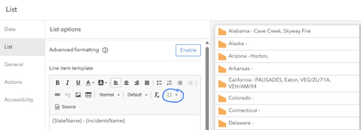

Here's an example of what I think you're trying to do, but with the Living Atlas current wildfires layer and the ACS population layer. For each state, I want to list the wildfires that affect that state:
// Get source featuresets
var wildfiresFS = FeatureSetByPortalItem(Portal('https://www.arcgis.com'), 'd957997ccee7408287a963600a77f61f', 1, ['IncidentName'], true)
var stateFS = FeatureSetByPortalItem(Portal('https://www.arcgis.com'), 'f430d25bf03744edbb1579e18c4bf6b8', 0, ['Name'], true)
// Create a dictionary for the output
var outputDict = {fields: [
{name: 'StateName', type: 'esriFieldTypeString'},
{name: 'IncidentsName', type: 'esriFieldTypeString'}],
geometryType: '',
features: []
// Loop through each state and see if it's affected by any wildfires
for (var i in stateFS){
  // Create variables to hold the name of the wildfire(s) and how long the name is, since I'll need to tidy that up later
  var wildfiresTxt
  var wildfiresTxtCount
  // Loop through each fire, and if it affects the state, list it
  for (var fire in wildfiresFS){
    if (Intersects(fire, i)){
      wildfiresTxt += fire.IncidentName + ", "
      wildfiresTxtCount = Count(wildfiresTxt)
  // Write results
  Push(outputDict['features'], {attributes: {StateName: i.Name, IncidentsName: Left(wildfiresTxt, wildfiresTxtCount-2)}})
var fsNew = FeatureSet(Text(outputDict))
return fsNew
Here's the result (Arizona is a little weird because at the moment there's one fire without a name, and I'd rather the states without fires just be null, but this is just an example):
Here's where you can add more fields to your list presentation:

NicoleJohnson
MVP
I see a "First" at the top of your code (which means you're working with one feature) and I'm not sure what the intention is there. That would be useful if you wanted to take the first feature in a featureset, but you'll need to go through all your features if I'm understanding correctly.
I would also create something (like a dictionary) to hold the output before you start "creating" the output (doing the intersection), if that makes sense? I also don't think you need all those Text functions in Push if those are already strings?
Also, you show the results of your code which does have the "status" field, but I think in the next screenshot (your dashboard list), you're wondering why you're only seeing the census tract name? That would be down to how your list is formatted, not the code.
geometryType: '',
features: []
  var wildfiresTxt
  // Write results
return fsNew
