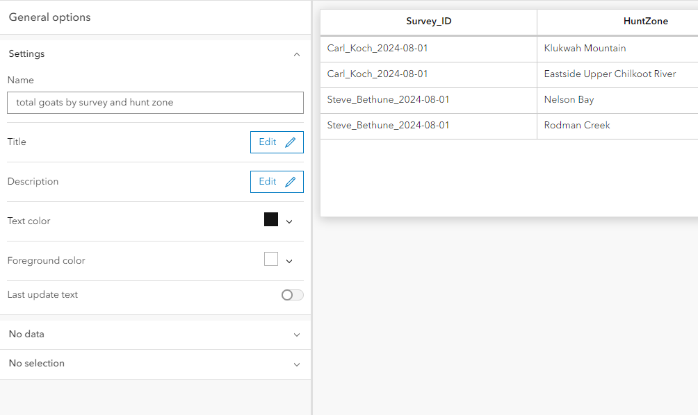

I want users to be able to download summary tables from a dashboard (I am just learning AGOL and dashboards). I created these summary tables of AGOL feature layers with Arcade code.
The instructions here https://doc.arcgis.com/en/dashboards/latest/create-and-share/download-data.htm say:
But I don't see any mention of download options within the 'general' tab:
Nor is there a download arrow at the bottom of the element as described in the instructions on the page.
Solutions don't have to be within a dashboard, although that seemed appropriate.
Thanks kindly for any help you can provide.

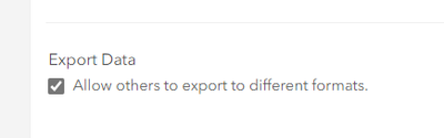

You might want to confirm that the feature service shown in the table is set to allow exports. It's at the very bottom of the Settings tab of the layer's Item Details page.
Hope that's helpful!
- Holly
DaveGregovich1
Thanks kindly. I have changed the settings to 'allow others to export to different formats'. But the nothing has changed from my original post.

DaveGregovich1
I have now done all of this to no avail. Thanks heaps for attempting to help. All I want to do is sum observation counts grouped by two factors; all the fields included are within a single feature layer. Maybe a dashboard is not the answer. I'm learning a lot, but stumbling a lot as well.
HollyTorpey_LSA
Bummer. I suspect it's related to having built the table through an Arcade expression. Have you tested adding another table using the layer as the data source rather than your data expression? I realize you'd only be able to group on one field, but it might be a helpful troubleshooting step.

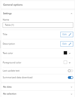

HollyTorpey_LSA
No problem. By the way, I created a data expression grouped on one field as an experiment and I was still able to toggle on a summarized data download. I didn't take the time to figure out how to group on two fields, so maybe that's the deal breaker.
- Holly
ZaaraKidwai22
Hi,
I have the same issue, and I was following the thread. Interestingly, I don't even have the option for "summarized data download" in my dashboard. My download button was coming the moment I set it up, and then as I added more features, it disappeared. Just wanted to point out that despite all steps mentioned above, this option is not there in my dashboard.
