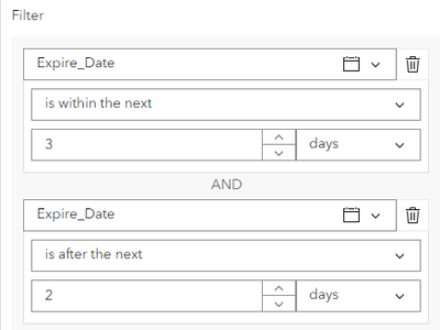

I have a layer with date field and in the date field having the data coming from the API. This data append for the next six days i.e. if I run the tools for append the data in that case data will be for next six days. I wanted to create a dashboard to show the every day progress using indicator or other widget.
When I am going for filter the data in dashboard, only today and tomorrow option is available. I wanted to filter the data for three day after the today date. I tried all the option available in the dashboard filter option but not getting proper result.
For Example if today is 8 July, I wanted to filter for the only 11 July data.
All filter should be dynamically.

JenniferAcunto
Date is within the next 3 days AND is after the next 2 days.
- Jen
Kristofer
Hi @JenniferAcunto
Thanks for the response. This is very helpful.
