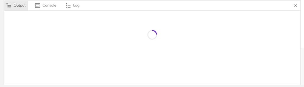

Lebowski
KenBuja
MVP Esteemed Contributor
If you have a lot of of sites and parcels, this expression will take a long time to calculate. To see how it's progressing through the parcels loop, put this Console statement at line 32
Console(parcel.name);
and check the Console tab.
