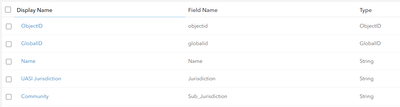

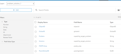

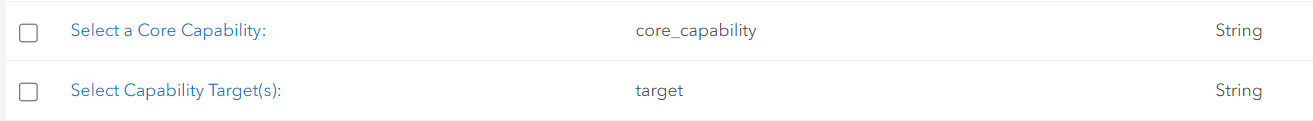

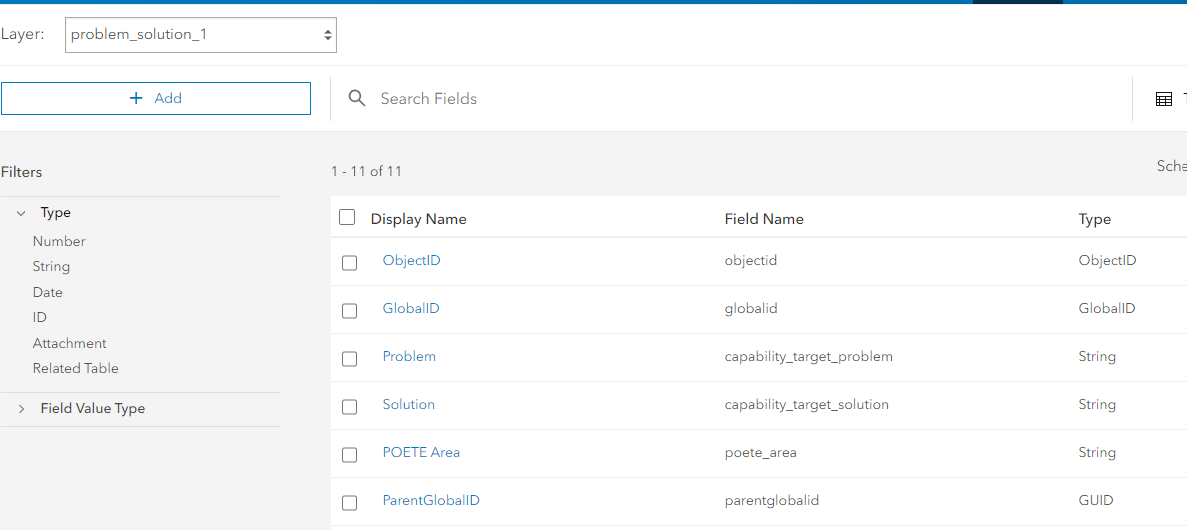

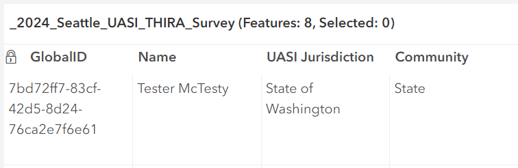

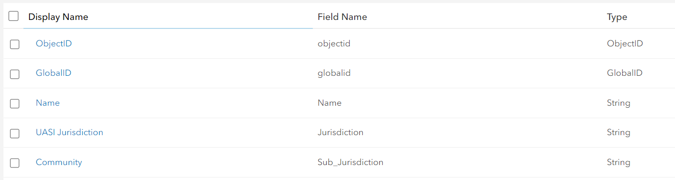

I am trying to write a data expression to return fields from 2 different data layers. My data expression looks like this:
var portal = Portal('https://piercecowa.maps.arcgis.com');
var thira = FeatureSetByPortalItem(portal,'aff5dd7c9615404cac256ec6dc627e10', ['*'],false)
var poete = FeatureSetByPortalItem(portal,'aff5dd7c9615404cac256ec6dc627e10', 1, ['*'],false)
// Create empty features array and feat object
var features = [];
var feat;
for (var x in poete){
  var ParentGlobalID = x["parentglobalid"]
  var poete_area = x['poete_area']
  var Name;
  var UASI_Jurisdiction;
  var Community;
  var Core_Capability;
  var Target
  for (var y in thira ){
    if (y["globalid"] == ParentGlobalID){
      Name = y['Name']
      UASI_Jurisdiction = y['Jurisdiction']
      Community = y['Sub_Jurisdiction:']
      Core_Capability = y['core_capability']
      Target = y['target']
      break
  feat = {
    attributes: {
        UASI_Jurisdiction: UASI_Jurisdiction,
        Community: Community,
        Core_Capability: Core_Capability,
        Target: Target,
        poete_area: poete_area
  Push(features, feat)
var joinedDict = {
    fields: [
        { name: "ParentGlobalID", type: "esriFieldTypeGUID" },
        { name: "poete_area", type: "esriFieldTypeString" },
        { name: "Name", type: "esriFieldTypeString" },
        { name: "UASI_Jurisdiction", type: "esriFieldTypeString" },
        { name: "Community", type: "esriFieldTypeString" },
        { name: "Core_Capability", type: "esriFieldTypeString" },
        { name: "Target", type: "esriFieldTypeString" },
    'geometryType': '',
    'features':features
// Return dictionary cast as a feature set
return FeatureSet(Text(joinedDict));

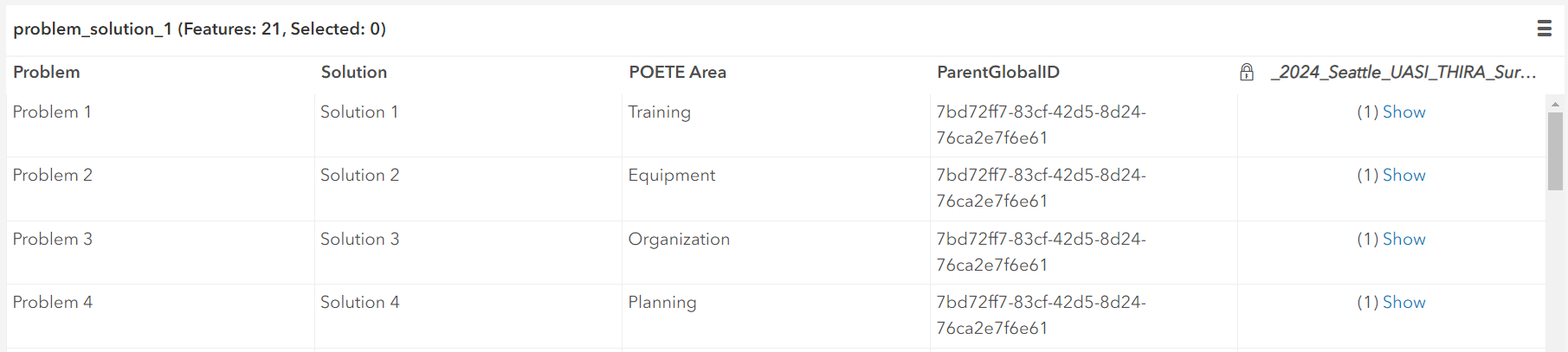

poete_area data:
thira data:
