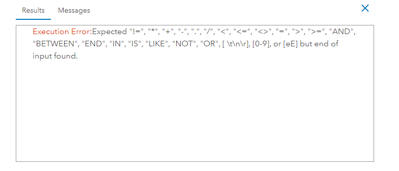

I then get this error

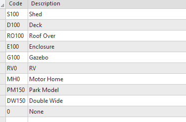

I should note that while these values are part of a domain they are the actual code and not the description (so the actual string of text that goes into the attribute field) Not sure if that makes a difference or not but wanted to put that out there.
Here is the domain table if it's helpful to know
