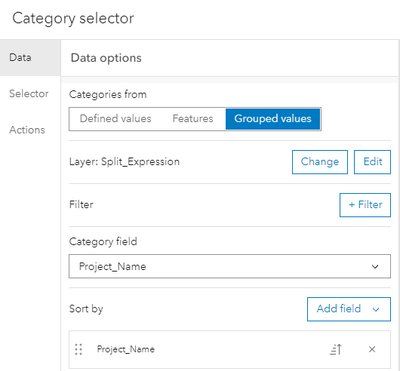

Add a side or top bar widget. In there, you can add a category selector. Point it to the data expression and use the project name column as group field:

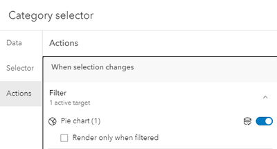

Set the category selector to filter the pie chart:

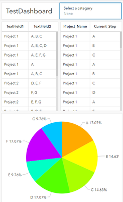

This is a quick example. The table on the left is my input featureset. The table on the right is the output of the data expression. The pie chart uses the same data expression.

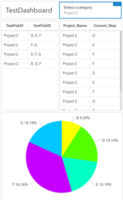

When I select a project, each widget gets filtered to show only features that belong to that project:
