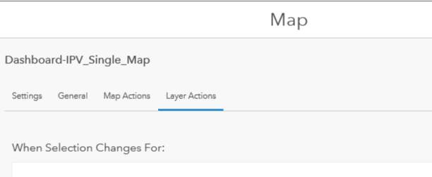

Not sure where I am going wrong or is my understanding wrong.
What does the Map -> Layer Actions do?
I have a map with a indicator attached to the layer. When I switch off the layer, I want the corresponding "Indicator" to go blank. Is that possible?
