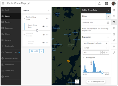

Hi, I have a web map that contains a Map Image Layer of crime incident points. In my web map, my layer has a definition query (filter) omitting all records where [MyLatitudeColumn]='48.00' (all records that had '0' or Null latitudes were field-calculated to this nice rounded-off number in order to handle them and keep them within the full set of features). So, in my web map, these features are not displayed, which is how I want it. The web map also has a duplicate layer in its table of contents that does not omit these same records (contains the full set of features), but it is not visibly displayed on the map (this is how I want it).
Web map:

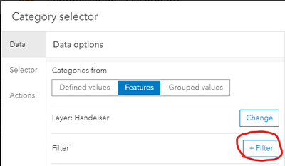

I do not know if this is expected behavior but a possible workaround could be to add the filter you have applied to the map to the selector in the dashboard. This works for both category and number selectors.
I appreciate the attempt, but doing this does not filter the layers displayed on the map.
