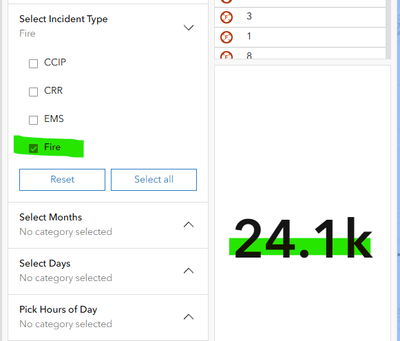

I think you just need to set the actions of your category selector to filter the indicator - for instance, here's an indicator that is being filtered by an incident type category selector I have set up in a dashboard - when no category is selected the number of incidents reads 115K.  The second screenshot shows where you set that up in the configuration panel for your category selector.

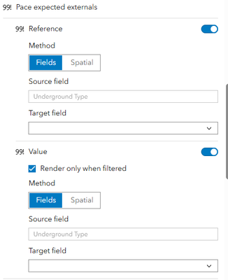

thank you @clt_cabq . How can I apply category filter to an indicator which also has a calculate value from reference data?
clt_cabq
I'd have to look at the specific setup, and don't currently have a dataset I can mimic that with easily. I think it would work the same though, the value showing in the indicator would calculate values based on the filter applied by the category selector. Give it a try and see if you get results that make sense to you.
TD1

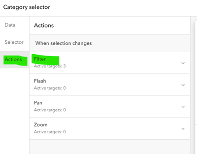

@clt_cabq Double checked and this one indicator still doesn't change on based on the category selector.
Below is a screenshot of this one indicator in the settings of the category selector:
