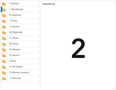

You'll probably want to have your employee names coming from a separate "master list" table, and have a List element driven by that.  Create an action that filters the indicator's Data Expression on your List selection.  I did this and here's what it looks like when I click on J. Sanderson, who had two points last night:
