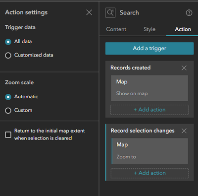

To my knowledge, there is no way to turn off the "bounceback" in dashboards with selectors, or in ExB with filters. However, in ExB, you can turn off the "bounceback" when selecting individual features (i.e. Search widget). This might be a good post for the Ideas forum.

Thank you. I don't get notifications when someone responds, so I sometimes miss them. This looks promising. I'll look into it.
