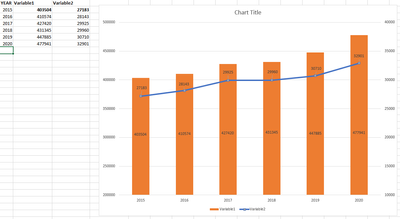

Is there a way to construct combo charts in ArcGIS Dashboard, something like this?

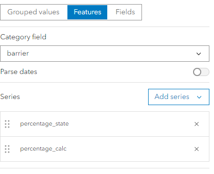

IsabellaDeMino
Been a while but if anyone is here, you just need to use the features on the serial chart and add multiple series.
