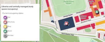

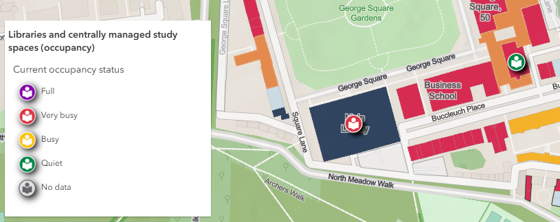

This works great and allows me to colour up my library point features based on how busy each library currently is (we have a process running in the background that updates the 'currentoccupancy' of each library feature every few minutes so that the user is presented with near real-time occupancy):

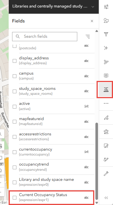

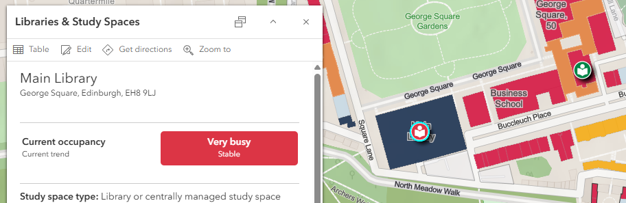

I have the exact same expression added to the popup area in my map so that the information is also displayed in the popup:
In the Fields area in Map Viewer, this expression is listed as a field at the bottom of the list:

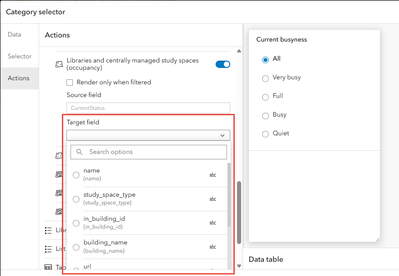

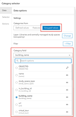

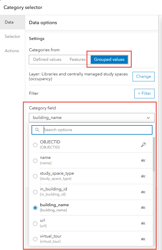

Now the bit I'm struggling with is using this map in a Dashboard, and I want the user to be able to filter the data using this 'current occupancy status' attribute expression, e.g. to show just those libraries that are currently 'quiet' or 'busy'.  The problem is, these attribute expressions don't appear to be pulled through in to the Dashboard and are not listed as an option in the Category Selector widget (I'm using 'grouped values' as I want to present the user with a list of 'quiet', 'busy', 'very busy' etc. etc.):
The 'Category field' only lists fields that exist on the actual hosted feature layer, not any attribute expressions defined in the map.

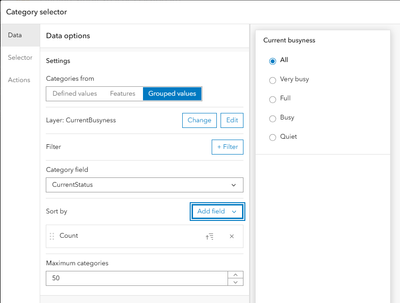

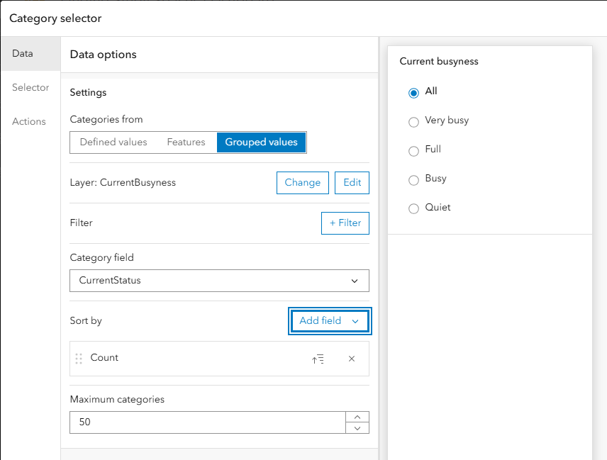

I've tried writing a data expression in the Dashboard that creates a FeatureSet and calculates the 'current status' of each library:

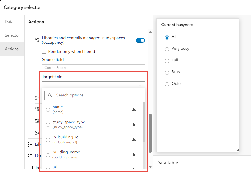

This looks promising as this is how I want the Category Selector to appear to the user, but I can't link this to the map in the Actions section because the 'Target field' drop down doesn't include a matching field in the Library (point) dataset (same problem as identified above):
