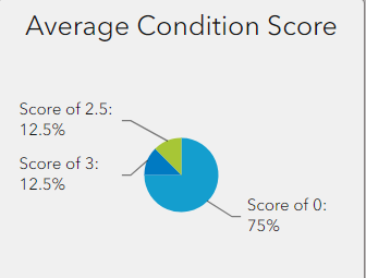

Hello Esri Community,
I’m new to using Arcade expressions and I’m currently working on designing a chart element for a dashboard. My goal is to group average scores into 5 distinct categories to improve the clarity of the visual representation in my pie chart.
Here’s what I’ve accomplished so far:
  • I’ve successfully used the created an "averagescore" field (average of 10 different features) in Arcade and used that expression in a pie chart
  • Currently, the pie chart displays all possible values calculated by the average, rather than categories or ranges
As more data is collected, this setup will likely become cluttered and less effective.
What I Need Help With: I want to categorize the average scores into 5 distinct groups so that the pie chart will be more organized and easier to interpret. Here are example category titles:
  • Score Between 0 and 1.9
  • Score Between 2 and 2.9
  • Score Between 3 and 3.9
  • Score above 4
Is there any way to do this within Arcade? Any advice or suggestions would be appreciated!

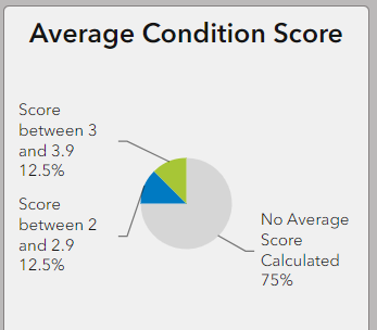

DanielleKuchler
Thank you, Nicole! This was extremely helpful. I was previously trying to use an "IF" statement instead of the "When" statement. I was having trouble defining my dictionary item 'averagescore' as a variable, but found a workaround for the time being using the full average calculation... it's very clunky looking on my end, but it works exactly as desired!
Here is what I ended up using to populate the 'averageScoreCat' field in my feature set:
//populate score category feature using averages
   'averageScoreCat': When(
                (Number(feature['Leg_1_Ftg_Score']) + Number(feature['Leg_2_Ftg_Score']) + Number(feature['Leg_3_Ftg_Score']) + Number(feature['Leg_4_Ftg_Score']) + Number(feature['Mid_Body_Score']) + Number(feature['Upper_Body_Arms_Score']) + Number(feature['score']) + Number(feature['Coating_Cond_Score']) + Number(feature['groundingscore']) + Number(feature['cathodicprotection_score'])) / 10 > 4, 'Score Above 4',
                (Number(feature['Leg_1_Ftg_Score']) + Number(feature['Leg_2_Ftg_Score']) + Number(feature['Leg_3_Ftg_Score']) + Number(feature['Leg_4_Ftg_Score']) + Number(feature['Mid_Body_Score']) + Number(feature['Upper_Body_Arms_Score']) + Number(feature['score']) + Number(feature['Coating_Cond_Score']) + Number(feature['groundingscore']) + Number(feature['cathodicprotection_score'])) / 10 < 4 && (Number(feature['Leg_1_Ftg_Score']) + Number(feature['Leg_2_Ftg_Score']) + Number(feature['Leg_3_Ftg_Score']) + Number(feature['Leg_4_Ftg_Score']) + Number(feature['Mid_Body_Score']) + Number(feature['Upper_Body_Arms_Score']) + Number(feature['score']) + Number(feature['Coating_Cond_Score']) + Number(feature['groundingscore']) + Number(feature['cathodicprotection_score'])) / 10 >= 3, 'Score between 3 and 3.9',
                (Number(feature['Leg_1_Ftg_Score']) + Number(feature['Leg_2_Ftg_Score']) + Number(feature['Leg_3_Ftg_Score']) + Number(feature['Leg_4_Ftg_Score']) + Number(feature['Mid_Body_Score']) + Number(feature['Upper_Body_Arms_Score']) + Number(feature['score']) + Number(feature['Coating_Cond_Score']) + Number(feature['groundingscore']) + Number(feature['cathodicprotection_score'])) / 10 < 3 && (Number(feature['Leg_1_Ftg_Score']) + Number(feature['Leg_2_Ftg_Score']) + Number(feature['Leg_3_Ftg_Score']) + Number(feature['Leg_4_Ftg_Score']) + Number(feature['Mid_Body_Score']) + Number(feature['Upper_Body_Arms_Score']) + Number(feature['score']) + Number(feature['Coating_Cond_Score']) + Number(feature['groundingscore']) + Number(feature['cathodicprotection_score'])) / 10 >= 2, 'Score between 2 and 2.9',
                (Number(feature['Leg_1_Ftg_Score']) + Number(feature['Leg_2_Ftg_Score']) + Number(feature['Leg_3_Ftg_Score']) + Number(feature['Leg_4_Ftg_Score']) + Number(feature['Mid_Body_Score']) + Number(feature['Upper_Body_Arms_Score']) + Number(feature['score']) + Number(feature['Coating_Cond_Score']) + Number(feature['groundingscore']) + Number(feature['cathodicprotection_score'])) / 10 < 1 && (Number(feature['Leg_1_Ftg_Score']) + Number(feature['Leg_2_Ftg_Score']) + Number(feature['Leg_3_Ftg_Score']) + Number(feature['Leg_4_Ftg_Score']) + Number(feature['Mid_Body_Score']) + Number(feature['Upper_Body_Arms_Score']) + Number(feature['score']) + Number(feature['Coating_Cond_Score']) + Number(feature['groundingscore']) + Number(feature['cathodicprotection_score'])) / 10 >= 1, 'Score between 1 and 1.9',
                'No Average Score Calculated')
Also, to answer the questions:
a) I am not sure what the index variable does exactly, but I used this video as the inspiration (timestamp 6:20): https://youtu.be/rowW2PistiQ?si=MtRzalunD6frOLU6&t=382. The variable is referenced again in line 28 "[index++]". I still have a lot of learning to go when writing code, there is a possibility this was an unnecessary step 🙂
b) I was indeed having a problem getting the average without the Number function 😞 The data was pulled from Survey123 and all fields were automatically set up as String instead of Integer for this data. The Number function was the only way the calculation worked without getting an error message.
Thank you again for your help!!
