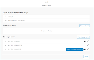

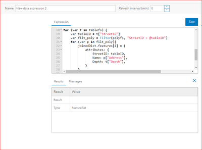

Hi Josh,
Thanks for your answer, I applied your recomendations, but it not working. When I click Test button, I don't see error:
But after click Done button I see error in the expression:
I shared this services as public for everyone,

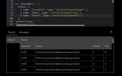

jcarlson
MVP Alum
Ah, I see it now. You are trying to cast the Depth as a "float", which isn't in the list of field types you can use (even though it is a valid data type in other contexts).
Change that to 'esriFieldTypeDouble' and it evaluates just fine:
- Josh Carlson
Kendall County GIS
Norchevskyi
Josh, thank you very much, it is working
