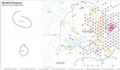

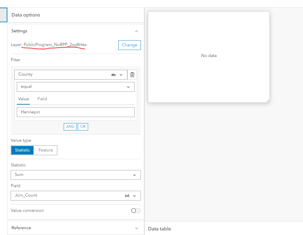

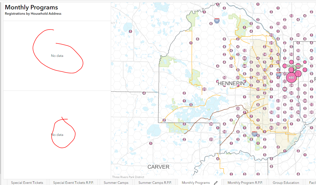

We've recently run into the issue where when we overwrite our service our ArcGIS Dashboard elements break. The layer in our service that's being changed has the exact same title and position in the REST (and no schema changes) therefore shouldn't be breaking the dashboard yet it is. This isn't the first time we've encountered this issue and would like to seek a resolution or learn if others are having this same issue.
Same layer name, still connected but not displaying after republish:
Please advise, thank you.

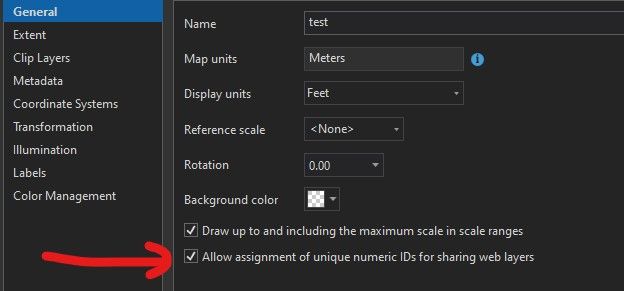

One thing to check if you haven't already is to make sure the layer IDs in the Pro publishing document are consistent. In the Map Properties - General there is a setting to "Allow assignment of unique numeric IDs for sharing web layers".
With that checked on you can now manually control the IDs for each of the layers in their General Properties. Look for the "Layer ID" setting.

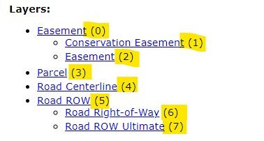

When published the IDs you set for the layers in Pro will appear to the right of the layer name in REST:
If you don't control this setting the layers will be ID-ed automatically by Pro. I would think each GP output would result in a different ID number.
