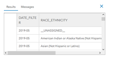

Thanks so much! That last line did the trick.
