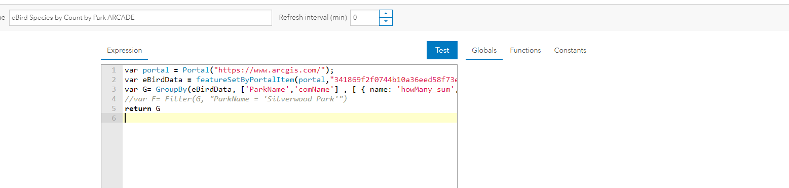

Hello ArcGIS Dashboard Team,
We've recently run into an issue in our ArcGIS Dashboard where our Arcade FeatureSet expression only returns 2,000 records (therefore missing a large chunk of our data). We have been unable to find documentation stating that there are record limits for arcade expressions.
Can somebody provide us more insight into this issue we're seeing?

I am experiencing the same issue, and it doesn't seem to be with the source data.  I am trying to create a dashboard to show tree assets, and want a widget to show ones with duplicate IDs (need to be corrected).  I can create a variable from FeatureSetByPortalItem that returns the correct number of records (~30K), and this is reflected in my indicator widget. If I apply GroupBy to the records returned by FeatureSetByPortalItem so I can get a count by ID, it's now limited to 2000 records.
