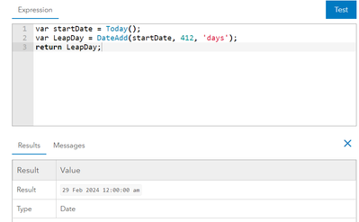

It considers the leap year.
I just did a simple test for you.
Google Result gave me the number of days until Feb 29, 2024 = 412 days
Added same no. of days in Arcade from today resulting in February 29, 2024.
