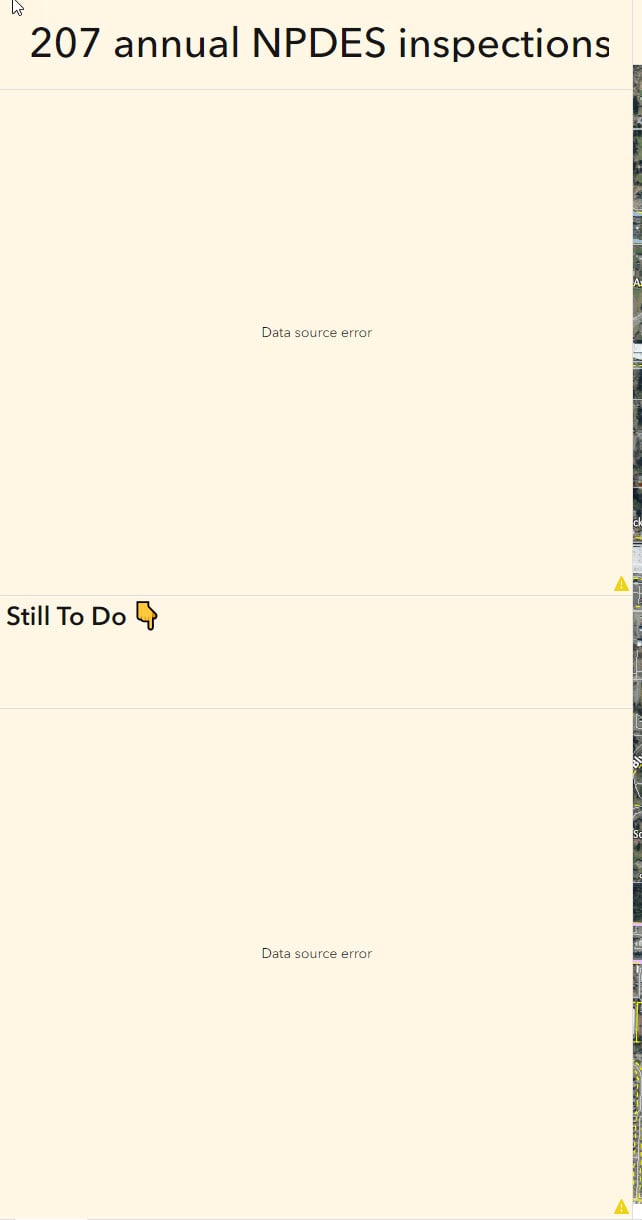

We have a Dashboard that helps the crews determine how many sites have been inspected for the calendar year and which sites remain that require a inspection for the calendar year. the first part of the expression (FIND INSPECTIONS FOR CURRENT YEAR), all up to the Console function works (console log picture), it identifies the sites, by unique identifier (FeatureIDN) that have a recorded inspection for the calendar year.
There seems to be something wrong or missing from the second part of the expression (FIND SITES THAT HAVEN'T BEEN INSPECTED), where it is supposed to compare CURRENT YEAR inspections and compare FeatureIDN of inspection and compare to the layer that has all the sites unique ID (IDN) and select the sites that have yet to be inspected.
I receive the following error: Test execution error: Cannot read properties of null (reading 'toString'). Verify test data.
I know that the console output is null, it just shows that the first part is working. I did not create the dashboard, my incumbent did, in 2022, it was brought to my attention about 2 weeks ago that it was not working (just the gauge and table that are linked to this data expression).Data Source Error.jpg
I have recreated the dashboard in hopes to find an error somewhere, also to learn. For the life of me I cannot figure it out, any help will be welcome and very appreciated. I have also attached a picture of when the dashboard worked prior to taking the position. Thank you in advance! The data expression is as follows:

Issue Solved: The related table, for some reason, had a null value in the FeatureIDN field. This was throwing the error when the expression was trying to execute line 22. I added a value into the table that was null, expression worked. Thank you
