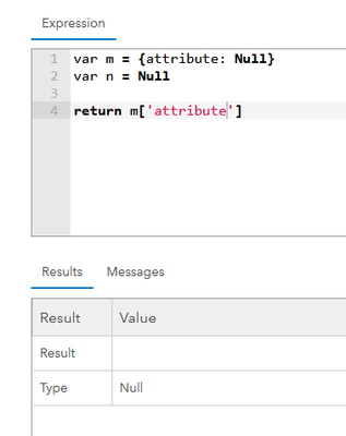

jcarlson
MVP Alum
Null fields are fine to work with, it's the fact that you're probably trying to pull attributes from a null. You end up with a null when your related records featureset is empty.
Throw it inside of a big if that checks the Count of the relatedrecords featureset, and only proceeds to add a feature if records exist.
if (Count(relatedrecords)>0){
    // do your recentrecord and feat stuff
If you want to add something to the output for features with no related records, you can add an else statement and manually define the feat object with strings like 'No inspections on record', rather than pull related attributes.
