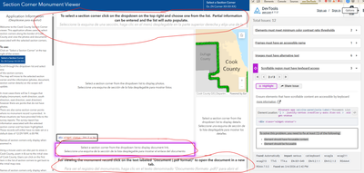

Similar to another post I made about Dashboard not allowing me to edit the html to add aria-labels and in this case add some tule of scroll capability to the section. Am I missing a step or where I can make this accessible from the Dashboard app?

  2. Run tool, we are use axeDev and it should match above image.

For this error, instead of setting my widgets or text to a percentage height, I changed it to auto, and the error went away. You can also set it to fit by using, for example, 30 px from the left. But in the section where you can set height and width, make sure it says auto rather than stretch or a percentage.

The accessibility errors disappear when using the List or Rich Text widget if the area is large enough to avoid scrolling. This isn’t an ideal solution. If possible, consider remaking this application in Experience Builder, where you have more control over widget behavior. From what I can tell, this is the only viable option.
