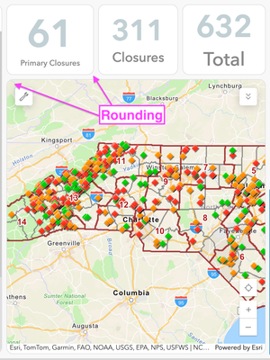

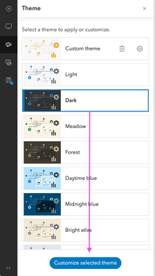

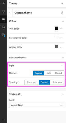

Ally here from the Dashboards team. Last year (June, 2024 ArcGIS online releasewe released new themes and controls for styling which allow for rounded corners in elements, in the spirit of supporting a more modern look. You can access these controls as you create a dashboard by opening the themes panel, selecting a theme- then within that same panel, clicking the "customize selected theme" button at the bottom of the themes list.
This opens up a panel offering additional styling capabilities, one of which is Style > Corners (see images below illustrating the panels and outcome of styling). Options for radius are preseet, with progressively higher radius as you move from Square, to Soft, and finally to Round.
