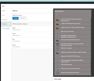

@ZorbaConlen1 perhaps I am misunderstanding, but you can already configure the popup to show when you select an item from the list - here's a screen shot of that part of the configuration. And as far as I understand, if a user selects a new item from the list, the popup panel that is displayed changes to the new item.

@clt_cabq thanks for the reply. For some reason, I'm not seeing that option in the list of actions. Odd.

@ZorbaConlen1 In order for the pop-up action to appear in the List (or other elements), the data source of the element must be a layer from the map element.

Yes, I opened a ticket and found out that the capability is not supported if the layers source is a query layer. That is classified as a feature defect and may be fixed in a future release.
So, just to clarify, this is implemented, but not for all layer types...
