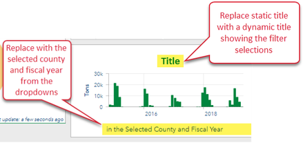

Add the ability to include dynamic values in the title and description of indicators and charts, based on selected filter criteria. For example, if an indicator or chart is filtered by a particular county, then the name of that county should be displayed in the title or description.

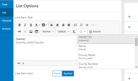

Lists have a way to show data from a field and this concept should be added to the Title and Description controls for indicators and charts.
