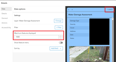

This is a question/suggestion,
What happens when the features exceed the 1000 maximum allowed displayed on the Details element? Will the older ones get filtered out and newer ones display, or will it not display the news ones after 1000 features?
I would suggest this limit be increased to something more like 999,999 if possible. One of our departments have been using QuickCapture for about a year and some features are nearing 500 points, halfway to the 1000 limit display. I created this Dashboard to have an easily accessible web page that can display their points collected with QuickCapture. However, now that I noticed this limitation and once it maxes out, I'm not sure this Dashboard will be useful. I know the main reason there has been many points (captures) is because QuickCapture only allows 5 photos per point, so our staff has had to make multiple points for 10+ photos on several occasions. I did forward the idea to the QuickCapture group to increase the photo limit, to reduce the number of points (captures) they have to create. It is the one thing all our QuickCapture users have asked for. Now I'm asking about this feature limit on Dashboards and how it will function when its display limit is maxed out. Any info would help, thanks.
2 Comments
RyanKelley_NA
I think if you use the Sort by functionality it will help control what features you see there.  Like if you wanted to see the most recent features you could Sort it by the created or captured date to achieve that.  You could also create several Details elements and stack them on each other and create different filters on each one to control what you see.  Just a couple ideas I had off the top of my head!
fjramos
Ryan thanks for the suggestion! That Sort function was actually something I was also trying to figure out, but I completely missed it. This will work for now. Thanks!
