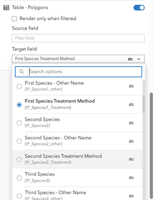

We need this too! I have a dashboard that shows polygons containing invasive species. Each polygon has five species fields that Field Maps users enter up to five invasive species. There are also five corresponding treatment method fields where Field Maps users specify a treatment method for each species. We want our dashboard users to be able to filter the dashboard's map and table based on a treatment method selected in a category selector, but it needs to check all five treatment method fields for that selected method. I need to be able to build an action with an OR clause that checks for the value in any of those fields.
Example: I wish I could select multiple fields here to build a query that returns features where my source field value appears in any of the target fields:
